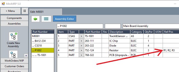

Reference/Designator is managed within a specific assembly. For example a common part that appears in many different assemblies willlikely not always occupy the same postion/ref/des on different PCBs.
So. Reference Designator is done within the assembly editor.
See the Ref/Pos column in the assembly editor here:-

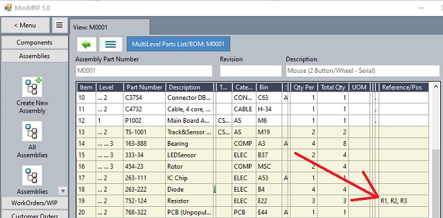

When you've created/edited your assembly the reference appears in the Bill of Materials here:-
In our example above you'll see by the Levels that this is in a sub assembly. You would obviously only need to edit the sub assembly once. If that was a common used assembly used in other products that ref/des would appear within the sub assembly. | |

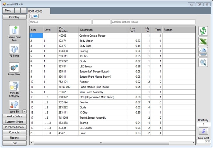

| By: Guest | Posted on: Nov 10 2025 at 09:01:05 AM | If you're looking at an assembly's parts list or a Work Order BOM you should see the Ref/Pos field. It looks like this
In the above example the 'Position (ie ref designator) column is empty but if it contained data then it would be visible in that column.
If, in your BOM, you can't see the column you can go to the menu and select the option to 'Show/Hide' columns and see that the column is checked.
Over to the right you see the big green [X] (excel) button. Click that to export the grid to CSV. The export should include that column.
